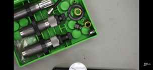

As you can see Triebel does make custom f/l dies in 7/8 x 14 format
