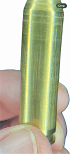

Do you have any photos of the brass?
I do have some slight marks from my whidden, harrels and redding dies.
If your brass looks like this which is hard to see unless the light is at an angle, I wouldn’t worry at all.
IMHO it’s irrelevant.

Since those marks go all the way to the .200 line, I would use 600 grit wet/dry emery with a high speed motor polish both the interior and the .200 line, I think your problem is at the die inlet.
Make some sort of a tapered cone effect with the emery cloth when going for the die inlet.
Good luck!
Yuck - wouldn’t be happy with that either. You’re 100% lubing sufficiently before sizing? Are both the horizontal and vertical marks present on all the cases? That’s a wierd combo
Those horizontal lines could be coming from a fired case that expanded in those areas. Try sizing a virgin case and see if the horizontal lines disappears. Could be the die is doing its job and the brass expands odd in those areas.
The vertical lines is what happened to my brass as well. Cleaning the die (I only cleaned the new die nothing after), using imperial wax, running some cases maybe 50 or so through the die eventually gets those marks out. After a lot of swearing those lines disappeared after usage. Like breaking in the die for whatever reason.
