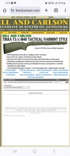

This stock I'm looking at .
That's the exact stock I purchased for mine. Fit wise, it is perfect with my tikka. There is zero stress movement when I tested it with a rifle stock bedding gadget with a dial indicator. So I'm really happy about that.
Weight wise, it's what I was looking for for my setup. Meaning, for prone field shooting this stock is great (what I consider tactical shooting). I would have no problems carrying it a 500 yards or so to get into shooting position (if I were shooting on state land). I'd consider this rig a 'light tactical'. Although if I had built it with that in mind, I may have gone one step up in barrel profile.
For deer hunting season, I swap out the B&C and go with a stock that is a bit lighter but more importantly less in size. I use the tikka wooden 'hunter' stock in November. I opened up the barrel channel a bit and resealed it. Keep in mind though, I'm the guy who wants to walk as far as possible into the woods to hunt and will tromp through dense brush and whatnot to get there. My type of hunting is not really what you you'd use a 'light tactical' rig for.
The Douglas barrel I bought was #4 contour, Heavy Sporter. Which is kinda like a Bartlein 3B. So bought the B&C stock knowing that my #4 would have alot of extra room in the barrel channel. I wanted options if I were to get bigger profiles in the future.
Based on your requirements, I would get the B&C stock and the Douglas Remington Varmint 007 contour. That is nearly identical in profile to the Bartlein Remington Varmint/Sendero. If you wanted to go a step lighter, it would be the #5 Magnum Sporter. Depending on your barrel length, It would be fine to carry for hunting season for most places except very thick woods.
I think I'll go with this stock for the tikka . I'm still trying to find the actual specks for the rem700 police barrel or similar . Possibly a tad heavier, not sure yet .
