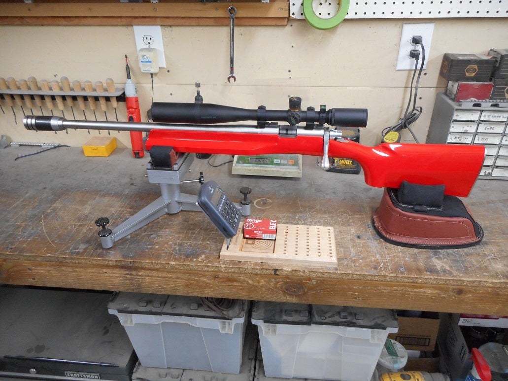

Just finished my V-22S a few weeks ago; it's a very fine action, comes with four extra striker springs - from 13 to 17lbs - that are easily changed so you can tune the action to work with the lightest of these springs that gives reliable ignition. I just tested mine with the l3lb spring last evening, and had 3-4 FTF out of 45rds, so when I got it back into the shop to clean, swapped out the 13 for a 14lb spring, and will try it again next chance I get. I chambered a Shilen R5 contour ratchet select match bbl with a Nevius reamer, finished it at just under 25", then put a Pro-X tuner on it. Vudoo offers the action with a 90* sear for use with a Flavio Fare trigger that's adjustable from .7 -2.8oz, or you can specify a 60* sear angle and use other custom triggers. I went with the Flavio trigger, and have been very pleased with it. Mine's in a McMillan Kestros stock, which I ordered with a BAT SS trigger guard. Very fine rifle, and I'm having a great time learning to shoot it with a PQP Precision Joystick one-pc rest.
