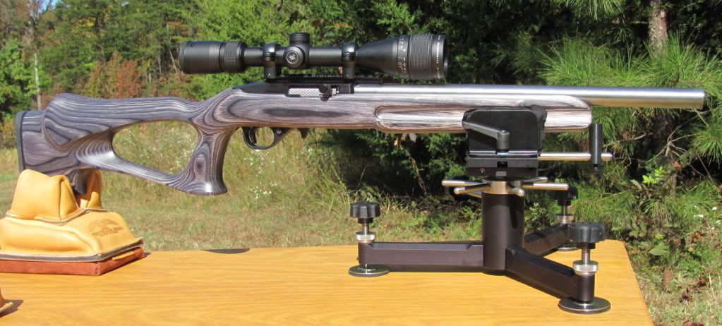

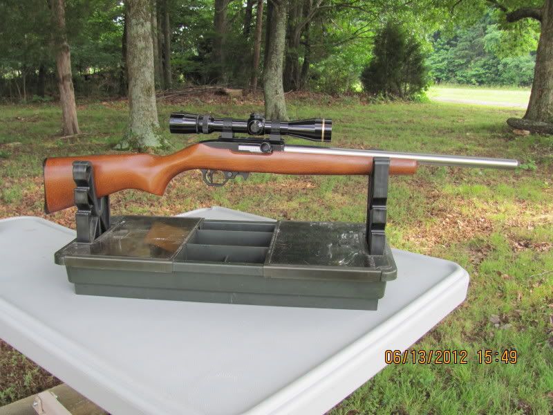

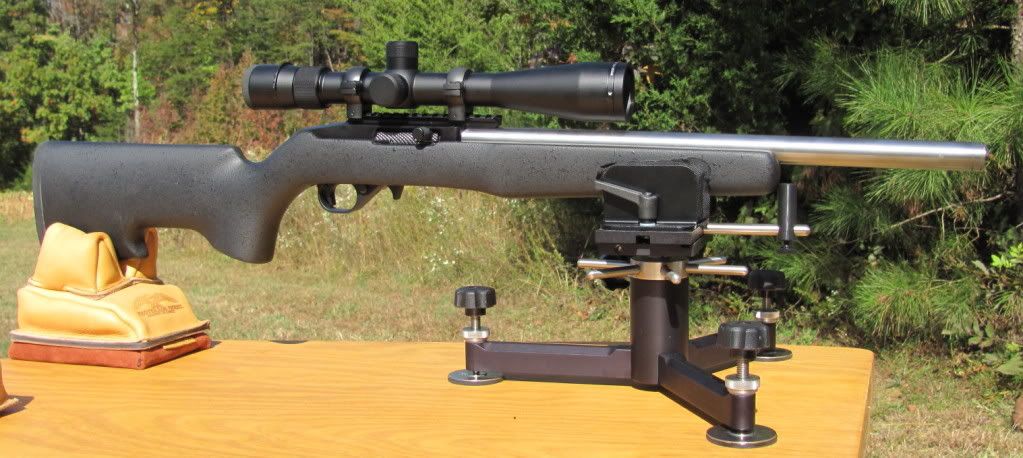

This stock is all what remains of originally a 10/22™ Compact, barrel channel opened up to accept Green Mountain 17” Heavy Taper.
Two of seven builds, four on Kidd receivers, Kidd innards, a 1.75 lb. Kit trigger, one a tad less than 1 lb. and another at 1.5 lb. Single Stage triggers, and a 3oz.+5oz. Two Stage trigger, and assorted Kidd barrels. These two as well as most me other 10/22™ tinker toys have undergone numerous components swaps betwixt ‘em.

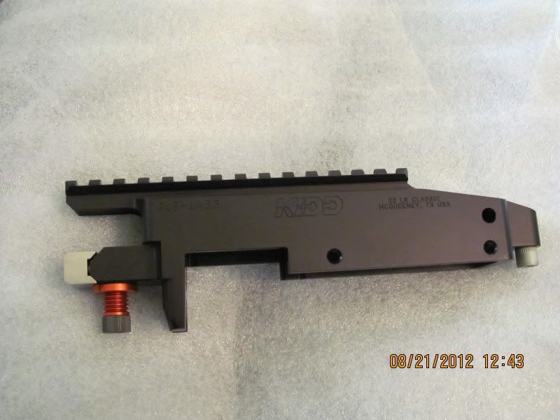

Kidd receiver shown with rear tang, up front is Raven Eye’s flanged pillar, escutcheon, and TD screw.
