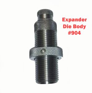

Thanks guys...I want to get a couple custom expander buttons, does RCBS offer them, or do I have to change to a Redding or some other custom die? Since these are mainly hunting, not bench rifles I am working with, did not see a need to spend couple hundred bucks for custom dies.
You can use a secondary expander mandrel. 21st century makes a nice one and any size is available

Thanks Dusty, I will look them up.
