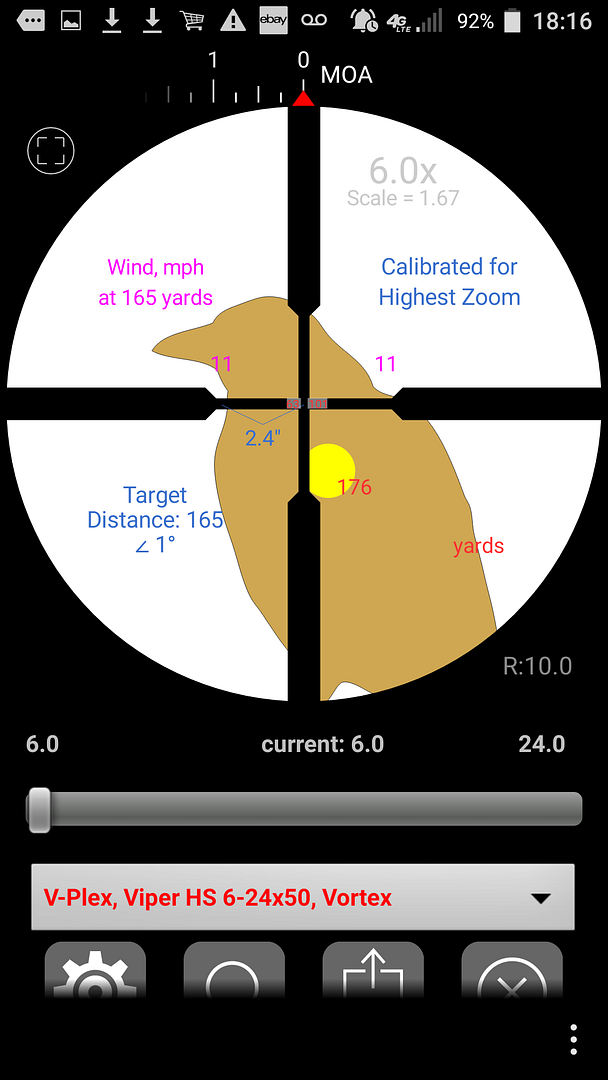

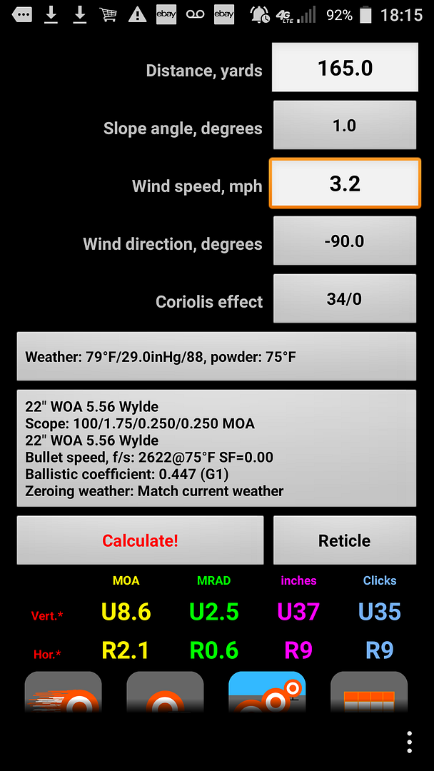

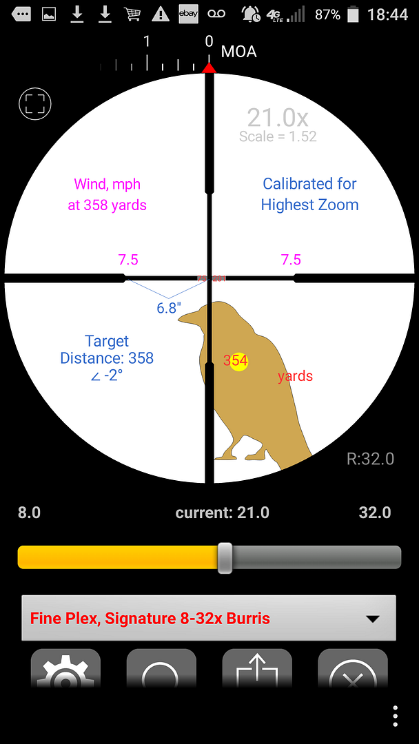

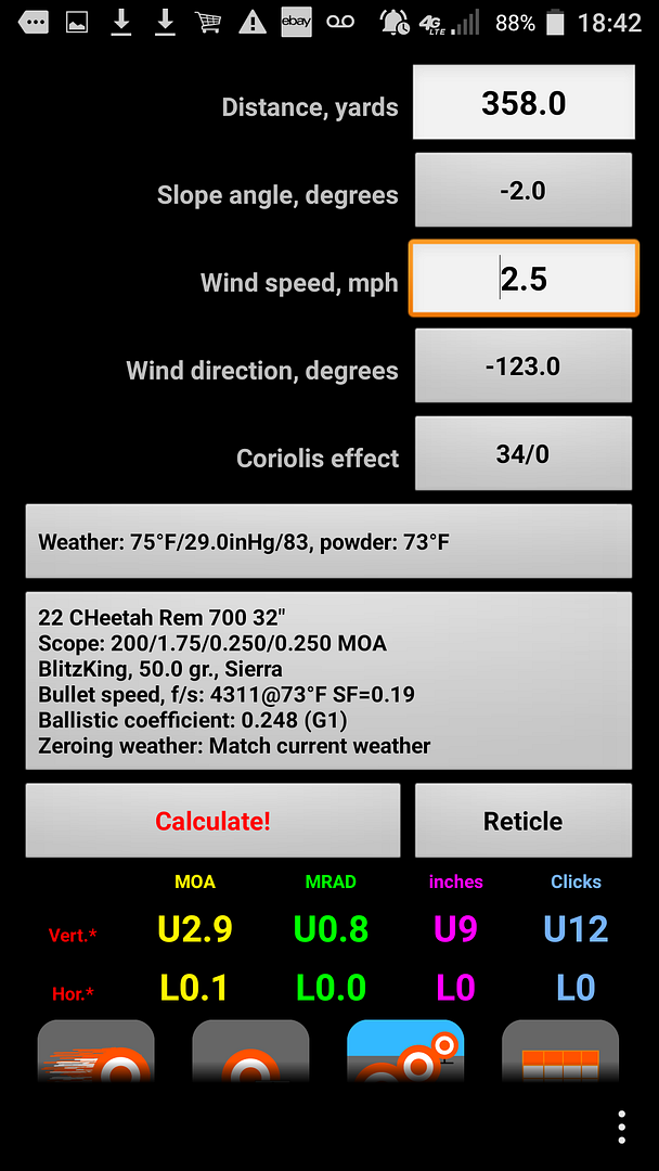

Test to see if some past crow firing solutions can be posted from screen captures. Should be range and wind data with firing solutions from three different rifles to show how easily can swap from one rig and load to another once defined in Strelok Pro.
No, they are not all the same height but have to work from some sort of average then use personal judgement to determine if looking at an average, juvinial or overly large mature bird. If ranging in a MRAD or MOA BDC scope these judgement calls are important. If use a quality laser rangefinder then size of varmint matters not except does your combined equipment have enough inherent accuracy to hit the chosen target at current range or do you need to call them in closer. Have recently purchased a higher resolution, longer distance rangefinder but previous unit is now my backup keep in truck 24/7 for varmints of opportunity is a SIG Kilo 1600BDX. It does start throwing error at 500 to 600 yards based on reflectivity of target and specs claim 750 yard maximum accurate range on deer. Unless specifically carrying a tack driving rifle capable of better accuracy than my SIG 1600BDX leave the new one at home so reduce risk of damaging it exposed to heat, cold and bouncing work truck.

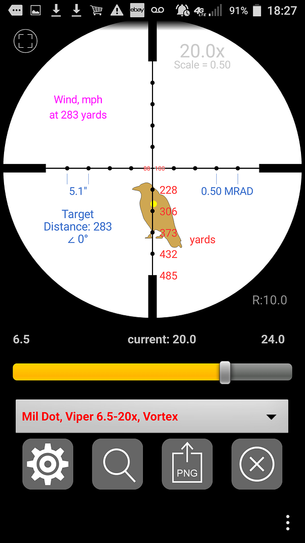

Don't know how well the OP is doing with his reticle-rangefinding but that's something I've done a lot of research with over the years due to the passion I have for it. If I were trying to range crows with a reticle I wouldn't use the total height of the bird, but instead the bellyline to top of head as a birds foot is going to be difficult to resolve if it's walking in grass. The smaller the unit of subtension you're using the better, and if I were using a mil-dot reticle (or even simple plex) I would use it at the optic's highest power to allow for a finer subtension unit, i.e. if you're using a 6.5-20X scope whose mil-dot is "cald" for say 10X, I would use it at 2X the magnification to obtain 1/2 the subtension (subtension is inversely proportional to magnification).
Something else I'd do is to "reverse mil" the target size in your subtension formula ("milliradian formula") after lasering the range on several different crows. That way you can get a more accurate tgt. size by leaving that as the variable in the equation.
