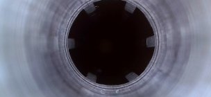

If it doesn't look similar to this then what good do custom dies and checking runout do? You're bullet enters the barrel and is immediately thrust out of concentricity.
