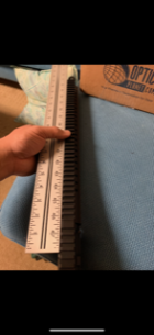

The barrel probably isn't cut square with the barrel extension.... It happens. Should of been caught before it left whoever built the upper.

Here is the handguard straight with the receiver, and the slight rightward of the barrel.

So you are using a sight that is attached to the upper receiver, independent of the rail, and considering your sight mount isn't off kilter, it would be the barrel causing the issue. It's not like you have a front sight on the rail that is bent and causing the windage issue.

Before condemning the barrel or fit to the upper, you need to also check the scope mounts.
Dismount and mount at the same spot and maybe one slot forward and back. You should be able to return to zero. Might even try a second scope.
There is no guarantee that the rail on the upper or the mount are square with each other.
Being able to remove and replace the scope without having to re-zero is something you will want to confirm no matter what.
This is also assuming you have confirmed that you’re no where near the center of the adjustment for windage.
