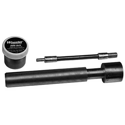

I have never seen an AR upper with a flat and square face unless it had been lapped. Betting that the builder didn't lap it.
