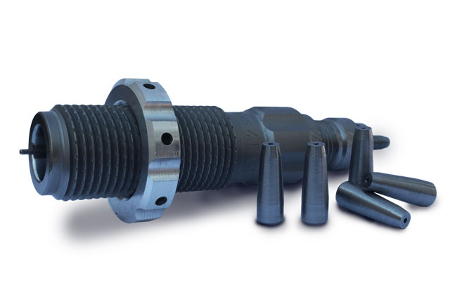

You can also increase bullet grip by using smaller diameter expanders. Whidden offers expander kits with five expanders from bullet diameter to .004 under bullet diameter.
