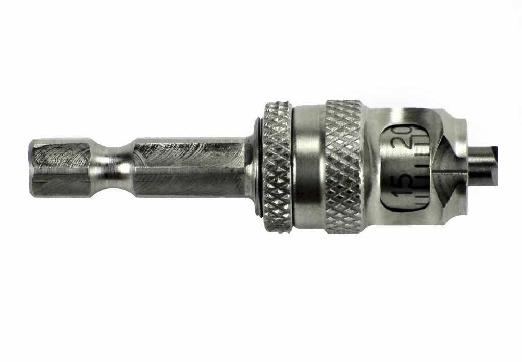

Yes I had the same issue with my K&M tool on Alpha PPC brass. A quick call to Pat at PMA and I received a tool to correct the issue. He offered either his PMA uniformer that is not adjustable for depth or the Benchrite which is. I went with the Benchrite and couldn’t be happier.
