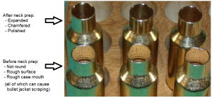

First time I have seen the bluish green copper flakes inside of the necks. Same powder, bullet lot, brass. Something that I need to be concerned with? Maybe chamfer/trimming residue?
Another potential source is bullet jacket material being shaved off during seating. It’s easy to leave a small sharp edge/burr during neck ID chamfering, especially if the tool is becoming dull. You can test by seating/removing a bullet then inspecting its bearing surface for scratches.
