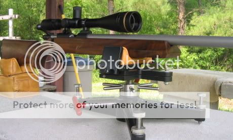

I'm really happy with my TRP-3. I got lucky when I found a wood stocked model. Cooper only produced 10 of these. They are good looking and accurate. If I do my part it has shot into a .09 @ 50 yards on a few outings.
