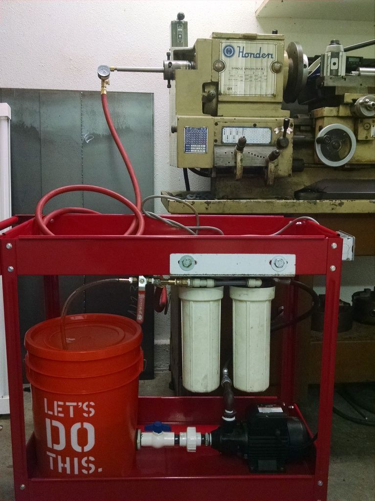

What spin on oil filter are you guys using? Standard oil filters such as on your Ford or Chevy have a average 21 micron filtering capacity. I could only find one hydraulic oil filter that had a 10 micron capacity. I think most guys were saying 5 micron was needed? Can anyone give me a actual filter number for a spin on, 5 micron, filter with a 3/4 inch center stud?
If you care, there is a link on the first page that I posted. It has the MSC #'s for a filter housing and 5 micron filter that I am using. Good luck
Tac;
I saw your post with all the great photos and I used quite a bit of your information. I have a spin on mount from a previous auto project that I intended to use with a standard spin on oil filter that has a 3/4 inch center stud. I have seen some photos that guys have used that type, just can't locate that type with a 5 micron filter pore size.
Thanks for the response and those great photos and details!
Thanks Doc.
So I had to refresh my memory here. The Shurflo pump I run will do 4.25 GPM, the 5 micron filter I am using will do 7 GPM in a water type environment, I'm running vipers venom,
So I did some searching and came up with a spin on filter for a Ford 6.7 L, it's a Wix #57151 or Napa #7151 the only draw back might be the 1-16 TPI vs a 3/4-16 TPI which I hunk I common in gas motors. There is one other option which is for a motorcycle, a Wix 57148 and it has a 3/4-16 TPI but is a much smaller filter of corse. I provided links for both.
Some product info on the Wix 57151 - $17.42 @ Rock Auto but a 1-16 TPI
https://www.rockauto.com/catalog/moreinfo.php?pk=2427384&jnid=301&jpid=0
Some product info on the Wix 57148 - $6.27 @ Rock Auto
https://www.rockauto.com/catalog/moreinfo.php?pk=3905046&jnid=301&jpid=0
There are many diesel fuel filters below 5 microns and they can be had in many different sizes. You can get external filter housings from Cummins among other places too.
Tac;
Thanks for the detailed response! The motorcycle filter may be too small even for the mount. I have looked at oil filters pretty well as well as hydraulic filters but have not thought of fuel filters. I will research those next and see what come up. Dusty may be right and just give up on using the mount that I have an go with the information on what you used. Thanks again to all!!

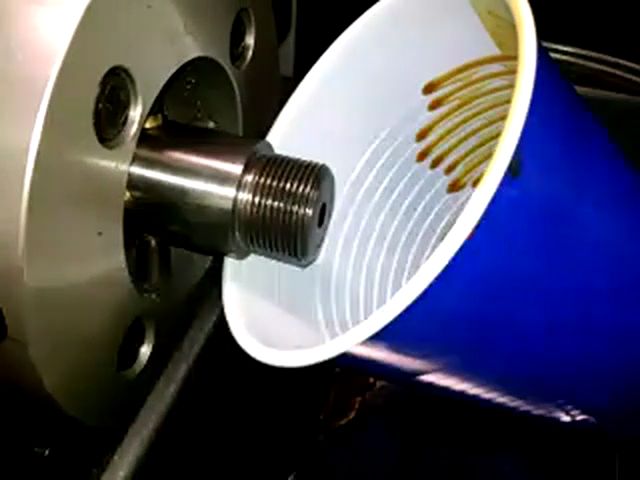

I just got my flush system setup last night, I went super cheap on it and didnt spend alot of money. The pump only puts out 45psi but its a pretty good flow through the barrel.
The pump is from harbor frieght so i dont think it will last too long but worth a try. What do you guys think?
This one is a video!
