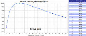

Check out post #9 from the late Donovan Moran

I figured out how to copy this graph from Donovan's post.

I think Moran is talking about something else--relative efficiency (which needs an explanation). This appears to be unrelated (or related in some way that isn't apparent) to the question of converting group sizes.
