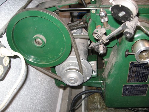

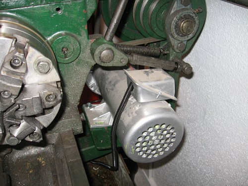

The lathe is a 1983 Jet 1236 Belt Drive. I simply swapped out the motor, leaving all the different belt drive system in place. I felt the main belt and the jackshaft belt both help to remove vibration from the motor.
Motor is a Dayton #2M169 90V DC

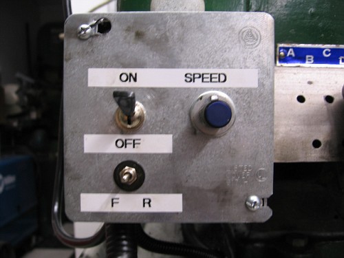

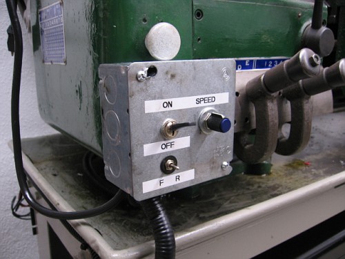

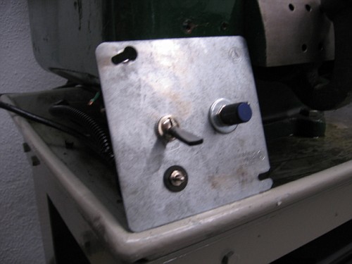

This is the control panel that will be mounted in an enclosure. Power ON-OFF, Direction, and speed

The motor I found on EBay is a Dayton #2M169 90V DC motor. I took a chance and bought it as I know next to nothing about this stuff and I got it at a great deal.,$90) List price is a bit north of $400!
It turned out to be a 3/4 HP, 1750RPM unit. 3/4 HP doesn't sound like much, but it works great on my lather. Much more power than the stock 2HP motor the lathe came with. You can buy it and see more info here:

The motor came with zero instructions. But only had two wires, so how bad could I screw this up! The controller came with very good instructions, a potentiometer, and a bunch of other hardware which made the wiring a snap.
All I added was a DPDT toggle for ON/OFF, a second DPDT toggle with center off for F/R, and a knob for the pot.
