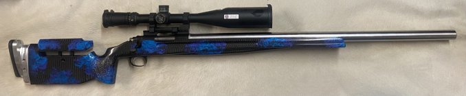

Several of us have played with putting barrels under tension inside large diameter aluminum tubes. It worked most of the time but was tricky to sort out issues. I did one where the barrel was under compression. It worked also. Other than a lot of expense and work none of it yielded an improvement in accuracy . It added complexity that when it didn't work was very hard to do a work around. Tuning as we know went out the window.
Even without the clamps, it’s definitely a task to tweak the channel fill so that the final barrel “weld” puts no positive angle on the barreled action. With clamps, now a negative angle has to also be considered.
The barrel “weld” to the channel once achieved, through heat cycles and the action screws’ continuous pressure, typically won’t let the barreled action fall out when inverted, even if the contact length is only a couple of inches. That’s of course without these clamps as this is the first time I tried them.

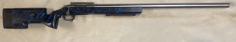

Here, there is more like 9 inches of channel contact. With this gun settling in and shooting, I don’t want to waste the effort and materials of maybe the best channel weld that I have attempted in the most “modest” stock choice I have, but I still want a comparison.
The compromise “partial” solution I have is to shoot the same company’s barrel, same reamer, smith, shooter, box of ammo and range day conditions, head to head, sometime next week.
This barreled action is a proven shooter in an F-Class stock, but I have yet to shoot it at all in this McMillan universal inlet, generously free floated stock.
The head to head has the potential to either quiet my curiosity about this, or add legs to my theory, for soldiering onward.
If this Defiance repeater action, free floated, essentially matches my 40-X, well, that’s basically that, free floating a long, heavy barrel doesn’t detract from accuracy relative to bracing and dampening one. If it beats the 40-X, same thing. I will have it on a Phoenix bipod with a top tier scope.
If the 40-X beats this McMillan/Defiance, with the same ammo, shooter and same barrel, against a stock that is better, with a very fine action and lighter, arguably superior Jewel trigger, then the next step may very well be to shim the McMillan gun’s barrel and see what it does.
The .243 gun that I consider the real “control” gun, if those two rifles above don’t sort out a whole lot, or all of this, I don’t shoot at 100, but I know that it performs at 600 very well and wins the typical club matches I use it in.
It is not free floated, but it comes a lot closer to free floating with only about a single 3/4” or 1/2” wide strip, below, than it does to what I did to the 40-X.
Conceivably, it could be shot at 100, as a comparison between a pure FClass setup and - I’m predicting, an old 40-X on a Harris bipod. Likely I will shoot that 40-X in the next 600 to compare it to the F-Open gun, going the other way, which most recently shot a 447/450 - 22, though the problem with that is different conditions.
I don’t know exactly what to expect, here, but I’ve been curious about this subject for at least a decade. I’m wondering if anyone has tried this, or has any hunches, as I have just assembled it and not tried it yet.
This is a 40-X with a fast twist straight 6mm chambered in .243 Win. It is not the .243 40-X that is shooting well in the Manners F-Class stock, that gun is undisturbed.
Along the lines of pre-stressed concrete beams, I have carefully filled an opened barrel channel with the correct amount of semi-compressible fill, such that once compressed initially with C-clamps, and finally with strap clamps, the action is flat (or will be after heat cycles), and the barrel is being pressed very tightly into the stock, contacted and semi-surrounded by dampening material. This is tricky.
Plenty of times I’ve padded the channel for heavy barrels, but I have never pulled the barrel down from the top, and it is under significant pressure.
Like action screws, these hose clamp straps can be tightened and loosened as desired.
The rifle is as “dead” as any I have handled. The goal, as always, is to shoot small, but I don’t know if it is a step forward or backward. It’s certainly a step toward my old Crosman.22 pump pellet gun, but I can’t say they were wrong regarding the strap.

Seems to me that this validates view of mine I have come to. A well put together from quality components properly chambered, bedded, assembled etc will shoot well under a MOA. A rifle that was assembled to price point will show it in performance....
Planning to shoot more tomorrow. I’m thinking that these straps, as part of a pipe joint, made over real or synthetic rubber, are temperature stable enough to contain fluids at modest pressure when conditions change, by reason of allowing a person to tighten them down well beyond contact minimally necessary for pressure retention.
In other words, here, I could probably loosen the bolts as much as a full revolution, lengthening the strap by a worm screw thread width, but still have the rubber under reasonable compression, pressing the barrel down. Once the barrel has made its final impression in the channel material, that material becomes firm and doesn’t have much further movement to give, nor to rebound, whether the barrel exerts x amount of force, or 2x, or .5x, and so forth, at least within the range of variances of heat and pressure that shooting outdoors applies, from what I’ve seen.
The channel takes on the final consistency somewhere between say leather, and leather that has been used in a barrel vice several times to clamp a barrel for installation. The straps are doing two separate things, really. The steel strap pressure is essentially tightly bracing the barrel and forend against each other, ((we’ve seen downward whip in thin barrels) while the rubber “liners” inside the strap in combination with the channel fill are essentially vibration dampeners.
There was a .22 match going on until the afternoon, where is was 102, with loads appropriate for about 60, such that when both barrels heated up, pressure was not ideal for accuracy in either gun, but especially the 40-x. We are taking safety glasses being a must. But it was even.
I just walked from one bench to the other every three shots.
The defiance chamber was a tad tighter and I stopped shooting it sooner, when I didn’t like the resistance.
I gave them both equal effort but feel that the defiance setup and trigger had a real advantage. The 40X had the bands manipulated and supplemented right before shooting and the McMillan stock, not barreled action, was shot for its first time when zeroing the scope, so that settling in was about even also.
I don’t know if someone has that program app to measure these, bit I will do later with calipers if not.
I feel like the banded gun wants to shoot tighter, probably did, but that off the same gear it would have been clearer. The trigger cannot be pulled without counter pressure on the old fashioned grip, or else the gun will really move. The Jewel will fire with or without using the grip.
Sequence of shots was left to right as before.
Rough caliper test put the groups as follows, with the banded rifle having a larger sample size. I may tend to measure them optimistically, but if so it is pretty uniformly done that way.
Because of the ammo challenges today it’s worth repeating in good conditions with lower pressure ammo. I suppose though that one of the main potential benefits of a strapped gun is that it’s going to constrain adverse conditions affecting barrel movements into a “smaller box”.
The banded gun’s groups were 81.5% as large as the free floated rifle.
