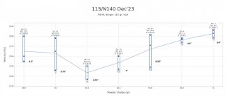

Circling back as I finally got to do the second round of testing. While I won't bore you with the results, I do have another question about some very confusing results...
How can an increase in powder yield a drop in velocity? I'm talking about three shots that are well under the previous two loads with 0.2 grains between each load?
Out of 10 different ladder tests (over the past two months) I had three clear examples of this effect. These were with three different bullets and two different powders, so not unique to one set of circumstances. One example (the most dramatic one) shown below.
What is going on here?

I believe that the ES of the previous two increments are skewing your point of view. Dis regard those numbers and judge point of impact on the target. You’ll find that once in tune a small volocity increase won’t change the poi.

That is just a typical example of under-sampling and the noise in ballistic testing.
An SD on so few samples is meaningless, so my advice is to carry on and ignore it. When and if you were to put enough samples into each step, two things would happen.
The line would tend to straighten out and the ES around each step would fully develop.
ETA: I agree with JFrank, watch the chrono, but study the target.
