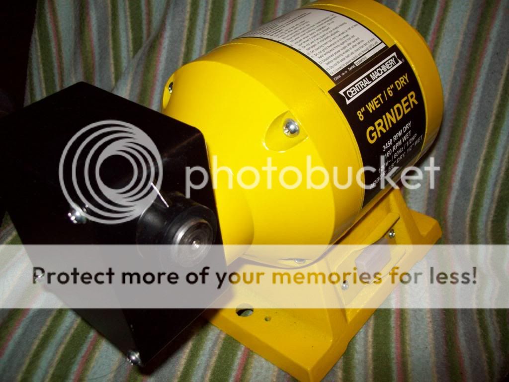

Hi,

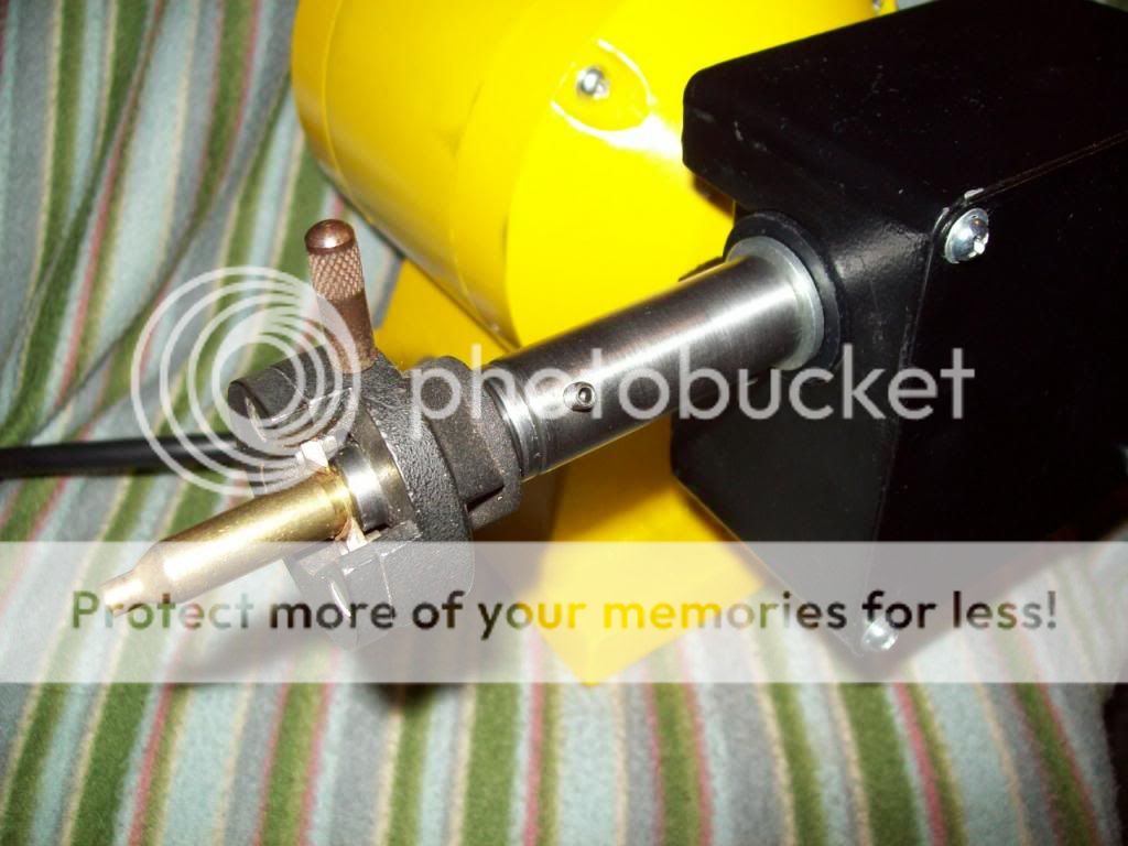

Here are the pictures of the completed case prep motor. A special Thanks to Kevin L who machined the adapter. Have not got to use it yet but turned it on and it ran perfect. 17 Fireball in case holder, the culprit that caused me to undertake this endeavor. Using it for a match chamber 17 Mach IV Contender. I am going to wire it up to a switch on the bench since the on/off switch is on the back. Will also be able to chamfer inside and out while turning.
Thanks to all who gave input and offered to help. A lot of good guys on this forum.
Safe shooting and good turning
Doug
Look sweet to me and cheap too.Whose shell holder are you using?
Less than $100.00 complete!!!! Shell holder is Lyman universal. Took this one off my hand trimmer cause I lost a spring out of the new one. Replacement on the way. Entire case holder assembly is less than $20.00 from Lyman web site.
Safe Shooting
Doug
