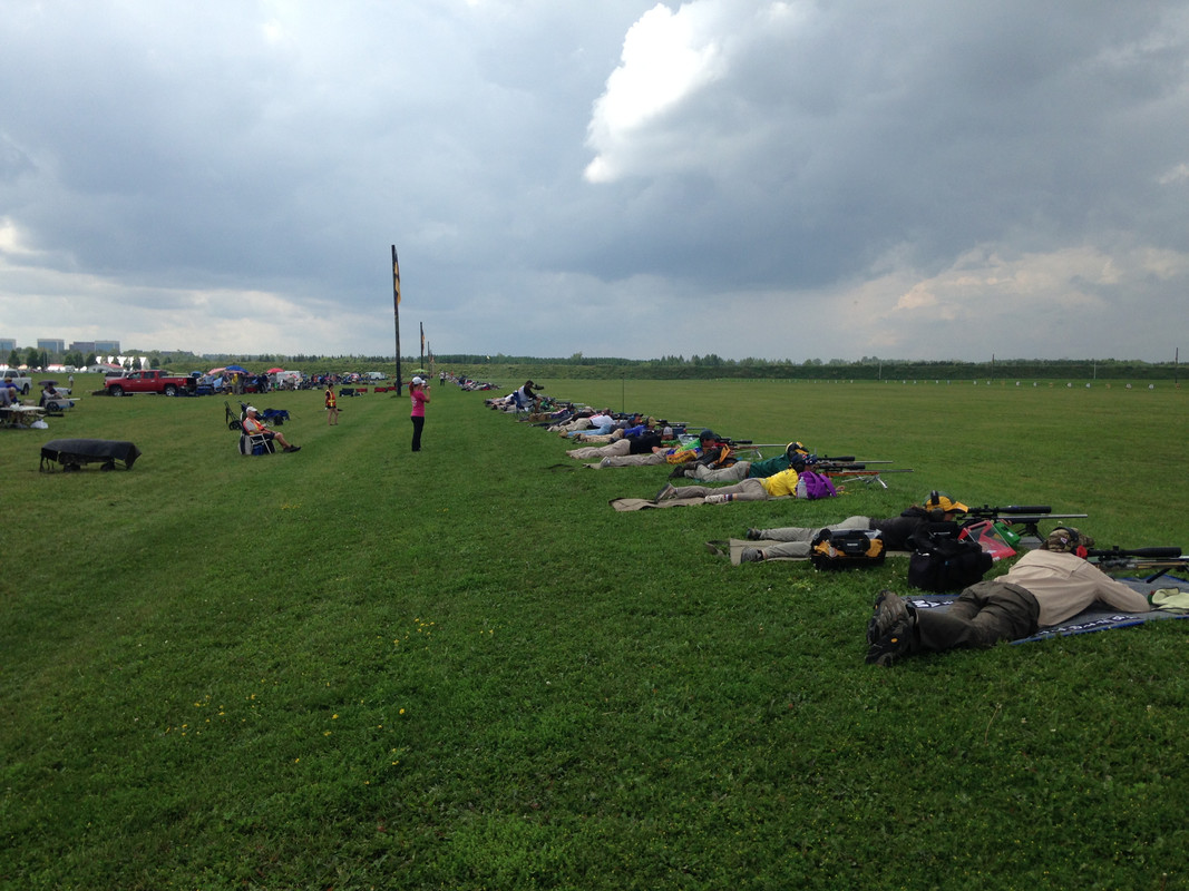

Calm before the storm...Immike thanks for the dry spot. lol @Turbulent Turtle
