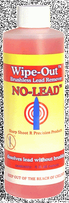

and or a Lewis lead remover
Lead is a fickle pickle. There are pros and cons. I can't see any way that the graphite will stick around long enough after the first couple of shots to help in any reasonable manner. Powder coat, gas checks or plated are some of the ways to prevent it but if you have build up you'll have to use the chemical or manual method to remove it. I always used long strands of copper chore boys scrubber pad wrapped around a used bronze bore brush and worked it end to end until the buildup was gone. Now that I powder coat there is no need for that any more. I shoot PCed cast boolits up to 1900 fps with no leading at all. Never pushed them any faster. I shoot several hundred in a single range session and the bores clean easily.
