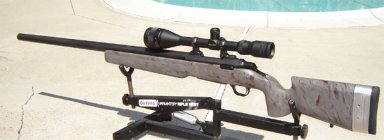

It's not what I expected but it'll probably be suitable, especially since these rounds are just for bbl break in. I mounted the scope last night, seated the rounds I made up to the proper depth and I'm ready to go. This first batch is 80gr Nosler BT's over 31.0g of Varget. I need to get a new 9 volt battery for my Chrony I guess. If the weather is good hopefully I'll get out and shoot this week.
rewinder said:
Hey PATRIOT is that a Browning A-BOLT II action resting in that stock.I have a 22/250 varminter with BOSS in the gun safe.Trying to figure out how to smooth up the trigger pull. RANDY
It is indeed. I'm trying to contact Jewell about that trigger issue, BTW. -Rod-
