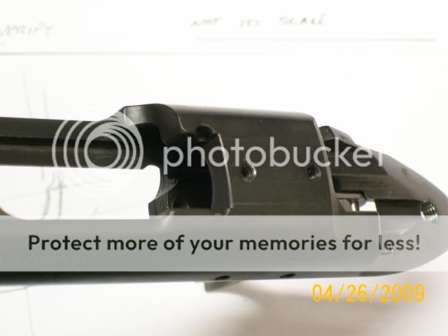

Hi,
I can do this service for you. What is the intended use of the slot? For highpower shooting, a Springfield/Winchester type cut is better. For an M40 clone, the 40X slot is required to index the scope base.
There are a lot of different ways to cut the slot, but one properly done will eject the clip when the bolt is closed.
Here are a few pics of different Remingtons I have done recently.
Thanks,
Ken
ohearchai said:
Ken , that is some excellent clip slotting
Thank you. I was taught and mentored by Jack Davis. He figured out all the little details long ago. If you shot any NRA highpower around central California from the mid 60's on, you will have heard of him. He was quite a guy.
