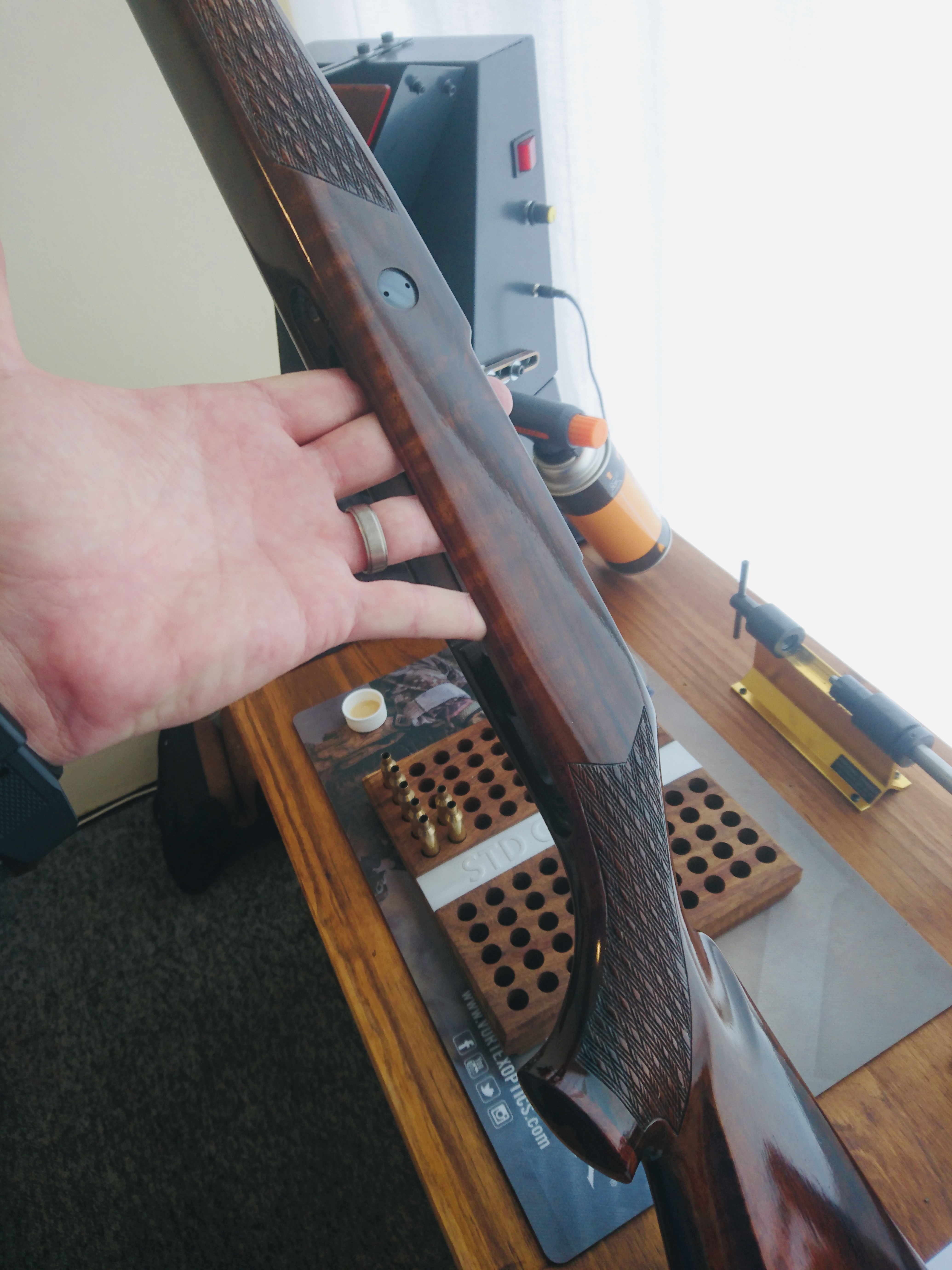

1664049134706.pngYou can put this on with a rag. It's a very easy finish. Unlike some traditional oil finishes you don't have wait very long to use it. If you have an ace hardware in town, they probably have it.
I just used a product a couple weeks ago called solarez I can't believe it's not lacquer. I am not totally sold either way on it, but if you needed to clear a stock and use it 10 minutes later, you could.
It cures with UV light in about a minute and is fully hard in about 5. It's %100 solids but requires a few changes over a traditional clear. I heated it in the microwave to thin it and sprayed at 45psi inlet pressure on my help. It looks pretty glossy and sands easy. Touch up is quick-ish and they claim no toxic fumes.
The bad parts: it's not cheap, you must sand prior to putting down another coat and it's not cheap.
