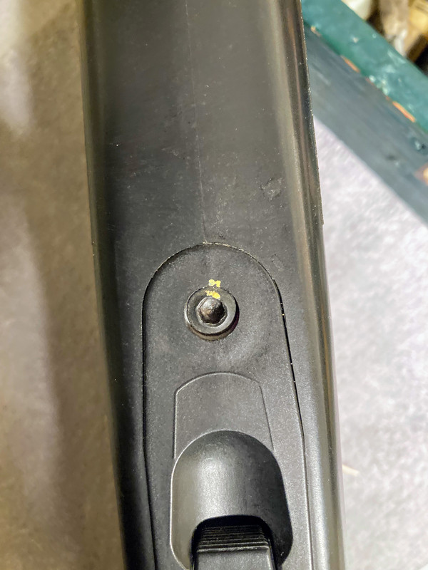

I haved used this method for decades, it is simple and almost foolproof. -
Before removing the acion screws put a small dot of fingernail polish on the screw and a small dot on the escuthion or triggerguard. When installing the screws simply line up the dots and you are back where the screws were originally tightened to.
