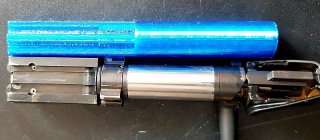

The ejector of the Bergara is quite different from other rimfire that I've own. Others were a rigid part of the action and quite agressive with the coated rod. On the Beraga, it's a pivoting (slightly) part, I found it to be less agressive even if I use an home made design (3d printed) bore guide.
Some day, I'll buy a "factory" made from delrin or so, as it will more convenient to keep the inside clean.
