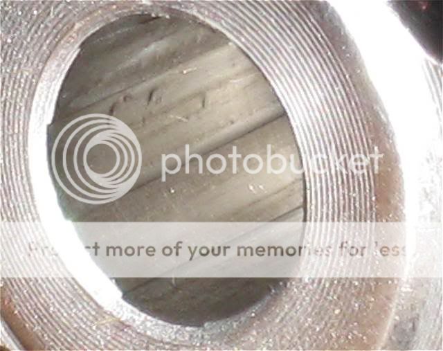

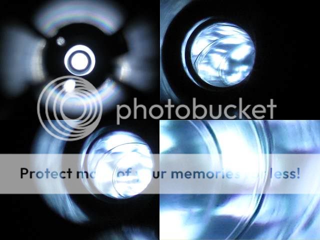

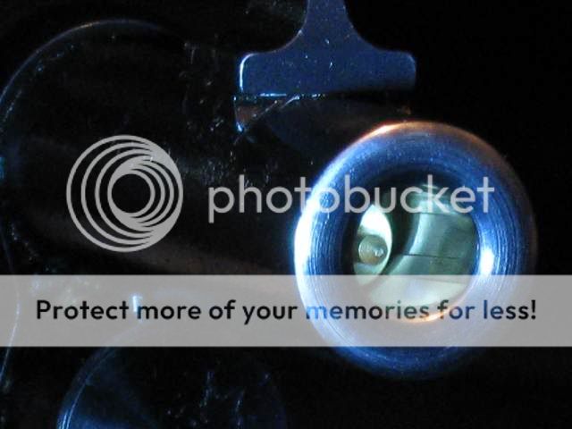

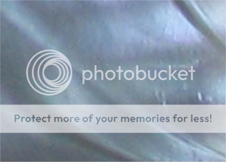

I posted it too soon...
This did have a carbon ring due to not using a bronze brush. When I noticed the ring is when I started using the alcohol.
Now I clean with Hoppes with a bronze brush, alcohol with a bronze brush oil with a bronze brush, and copper solvent and a nylon brush; with all my rifles, and see no signs of a carbon ring forming.
And now the 30-30 is a totally different rifle, bore-wise.
I shoot every day.
