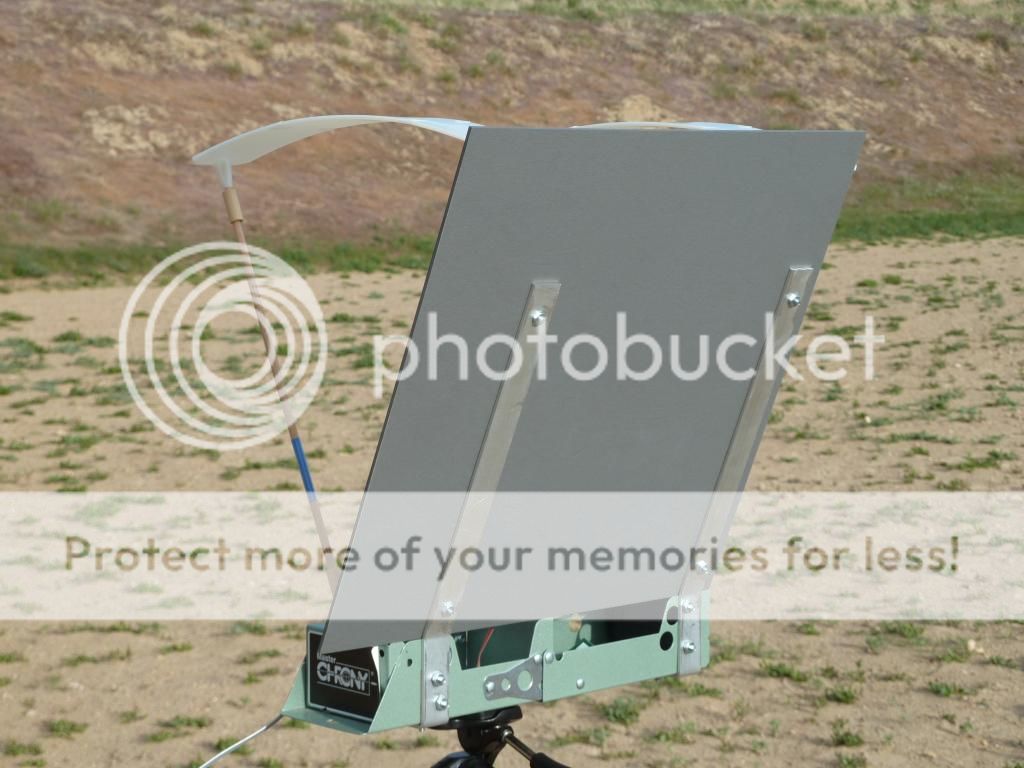

I really like it and it has performed very well for me. I find I don't use the printer as much any more, so you could save a lot of $$ getting a model without the printer. I like the feature of having the display setting on my bench with me. Very easy to ignore a shot or clear a string. I did make some changes to mine to suit my use.
Mine rarely misses a shot and when it does it means I don't have sun on the diffusers yet in the early morning. But I added a sun shade to mine. When the sun is low in the sky I found the "glint" could cancel the bullet shadow. Since I did that, it just works. I will include a picture of what I added.

[URL=http://s860.photobucket.com/user/jepp2/media/P1010244_zps0c1d9259.jpg.html][/URL]
