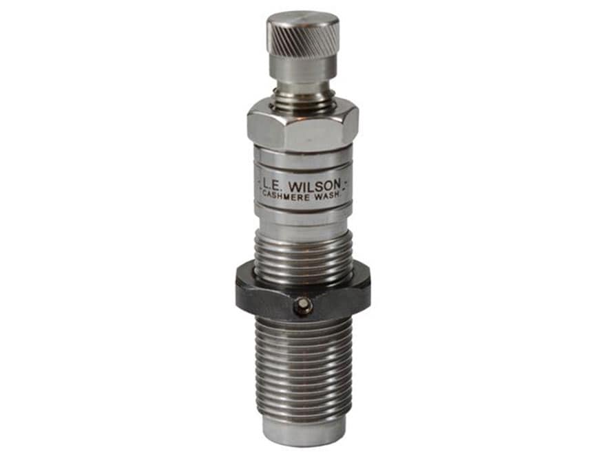

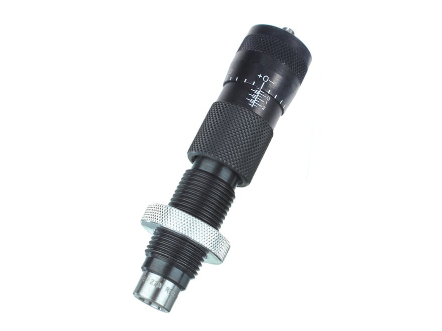

Im not sure where you are searching but 6BR dies are in stock all over.. If you need some help finding let me know but here are multiple FL, FL with bushing.

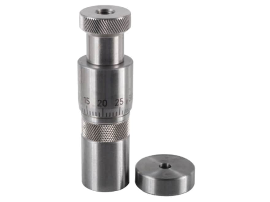

Do you want to seat with arbor or standard press? Here are both in stock and ready to ship. Forster and Wilson

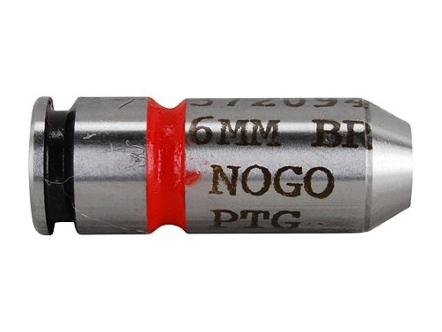

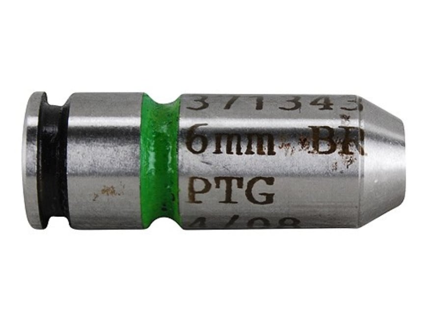

Here your hard to find 6BR headspace gauges. Both in stock and ready to ship
