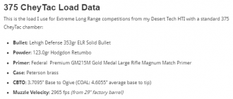

Here is a load:
https://precisionrifleblog.com/2013/08/17/rifle-reloading-data-my-pet-loads-for-target-and-hunting/
Scroll down for .375 CT load.
