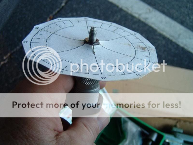

Here is a way to convert a straight seating die to a "sort of" micrometer seating die.
Pictured is a wheel divided into 36 segments which is what the thread pitch is for a RCBS seating die. A friend created a drawing using a computer drawing program and emailed it to me. I have a screwdriver that has the blade bent 90 degrees (for tight places). It makes a great pointer.
For a Redding seater the wheel needs to be divided into 50 segments. And I don't know for other seaters.
You may want to re-count the thread pitch on your RCBS seater stem!!
#10-32tpi to .22
1/4-28tpi .25 & up

firearmdoc1 said:
I may be missing something, but if an RCBS seater is 28 tpi, why would you make a scale diviced by 36?
Well, when you have 28 threads per inch, each thread is .0357" long (divide 1 by 28). So that means one full turn moves the bullet seat up or down .0357" (let's round that off to .036" or 36 thousandths). 1/2 turn would be 18 thou, 1/4 turn would be 9 thou, and 1/36 turn would be 1 thousandth.

Great idea but wouldn't the tension of the lock nut influence the precise measurement? I use a similar system on my Forester BR seating dies, I just didn't make the dial. I just know 1/32 turn = about .001
Bill
Bill
Doesn't seem to, Bill. But I never loosen the locknut - just keep it snug enough that the screw can still be turned.
