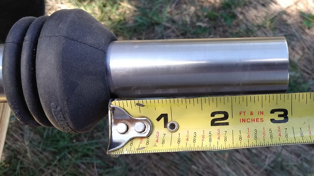

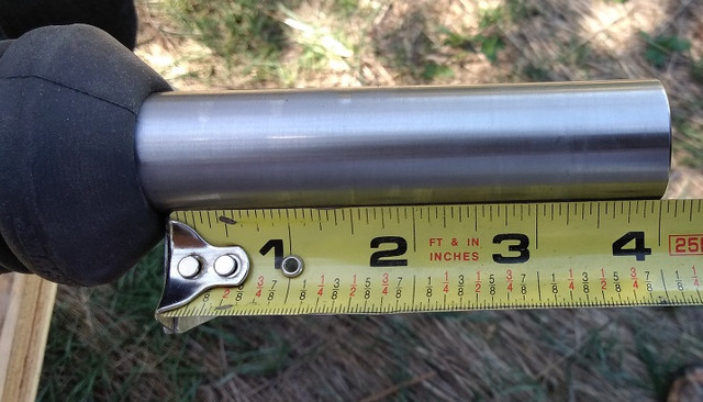

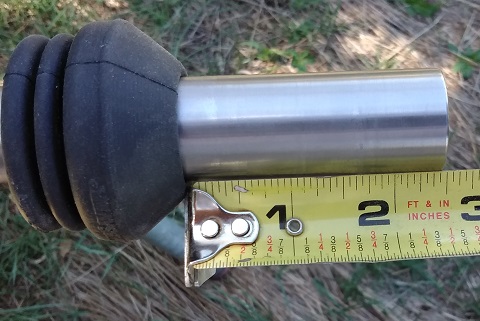

Today was a great day for shooting. 78° and very calm. I had bought the LimbSaver Sharpshooter X-Ring Barrel Dampener a few weeks ago, but never had the chance to try it out until today.
Savage short action.
Shilen 1:8 Select Match 6mm BR.
Fresh from the box Lapua brass.
CCI 450.
31.2 grains RE-15.
Moly coated 107 SMK, .020" off the lands.
200 yards.
5 minutes between groups while using a barrel cooler in the chamber.
Fired three shots with the Magnetospeed to warm up the barrel and get some speeds. 2878 fps.
Made a small scope adjustment and put the dampener on at 3/4" from the muzzle.
Moved to 1 1/4".
Moved to 2". Spaced out the 1/2" per step here.
Remembering the 1/2" per step, I moved to 2 1/2".
3".
3 1/2".
4".
With the last three rounds I had, I gave the 2 1/2" position again.....and I was so happy to see the first two touching, but managed to psych myself out and pulled the third shot. :(
Will test more this weekend around the 2 1/2" mark and see what happens. For $10, I am very happy.
