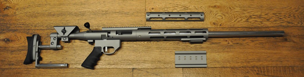

This is the C.G Model 66 rifle, it has a 22,0mm three lug bolt, C.G Model 22 trigger and has a chassis that offers the ability to swap between disciplines very quickly. The LOP, offset etc is full adjustable, the cheek piece is indexable up and down plus can be moved back and forth and rotated around the main tube so you really can adjust this to your shape. This particular rifle is fitted with the F/TR bipod pickup , above is the optional TR accessory rail and below the optional front bag rider plate so you can shoot it as an F Open, F/TR, TR, MR or BR rifle with not much more than a hex key to make the changes.
Greg, right now there is nobody dealing with the C.G Model 59, M66 or M75 over your side.
I forgot to add, this particular rifle is fitted with a 26" 6mm heavy profile barrel still only weighs in at 5.75kgs excluding a ‘scope so there is plenty of room for even heavier/longer barrels and optics in all disciplines.

interesting stock and bipod. Really interested in that bipod is there a arca type connector for that?
I prefer F-class over pure BR, and all my precision rifles are chassis guns.
I don't like shooting out of 1-pc rests. I tried it. That's not shooting. It's dialing.
You revived an 8 yr old thread; however, that may be a LRA bipod. Just based on the age of the picture that one may not be made any more.
