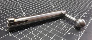

Mini Mausers are not controlled feed. They have what is similar to a mini 16 type extractor. The extractor snaps over the rim as the bolt is closed. The rib on the side of the bolt is a baffle to block high pressure gas from venting into the shooters face. Any alteration to those parts for the issue at hand will most likely lead to more heartache.
The picture of the bolt face appears to be small head size (.375"/.223 cal) so that part is right. The shoulder of the 204 is a bit forward of the 223 so it would seem the release points in the feed rails are not "timed" correctly for the round you are trying to feed. Also check the box for shoulder "bumps" in the wrong place for the longer round. Why it wont feed from a single round laid on top might be lack of a sufficient chamfer.
The 'Mini Mauser' nickname was stuck on these by gun writers. They were never termed anything 'Mauser' by the mfg or importers. The only thing 'Mauser' about these actions is the bolt shroud and bolt release. The rest of the bolt is just like a small Sako.
My Interarms Mini Mark X bolt with new extractor and old one.
