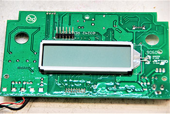

Here's some interesting info from the site above, They "may" be the only company regularely rebuilding Chargemaster units and they are recommended by RCBS themselves.
rcbs-scale-dispenser-system-repair
