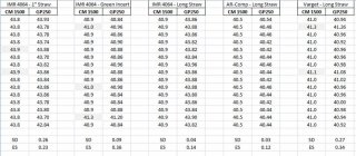

So, here's some numbers that represents what I experience with throws on my ChargeMaster and compared to my GemPro 250's measurement as I experimented with inserts that helped improve results from having no insert at all. I used a 1" straw that didn't improve the throws much from going without anything. A green insert is one of 3 that I bought that's designed to help with different sized orifices. And the one one that did best was a long straw that went almost all the way back leaving a small opening for the powder to feed into the tube. Results vary by powder and I always get consistent throws with AR-Comp for some reason. Because of similar size kernels, I thought Varget would throw as well as AR-Comp, but it seems Varget doesn't flow as easily (maybe something to do with the coating).
If you'll note in the picture, I've highlighted the overthrows by the ChargeMaster in grey (there were no underthrows according to the ChargeMaster), which tends to happen with the powder kernels bunch up and drop during the trickle stage. My long straw leaves a small feeding space that mitigates the bunching up by reducing the amount of powder flow down the tube. I've seen someone use a long straw set all the way back but with a slit cut into it to control the flow.
If I was able to shoot a one hole 5 shot group at 200 yards I could see being super accurate on my powder charge , I can shoot 1/2"on the average 5 even 10 shot groups at 200 yards . By fine tuning my loads didn't help much with me in the equation so 40. 4 is good enough with the CM1500..

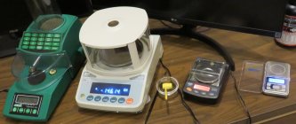

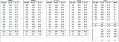

And since you put this question in my mind as to just how accurate my GemPro might me, having plenty of time on hand, I thought I'd run some more testing. This time, I managed to get hold of an A&D FX-120i to pit my GemPro against and proceeded to see how well my CM-1500 did (and even my little Frankford Arsenal DS-750).
This second run surprised me as my GemPro-250 showed to be as consistent as the FX-120i and almost as accurate. And it shows the CM-1500 to be as accurate as expected. Surprisingly, my little DS-750 was pretty much in line with the CM-1500.
Here's that data:

You're so right about the need to be vigilant with calibration check over long sessions. In this test, it was done over the course of a full day. I found I didn't have to do any recalibration, but did have to rezero a few times (especially on my GemPro).
