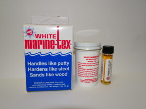

I used Devcon Steel Putty several times 10-15 years ago to bed several rifles. I got a quart size can. I need re-bed a few rifles and then a couple of new ones. I have read that Devcon changed their formula so it is no as thick as it used to be and doesn't set as hard. I ordered a tube of Marine-Tex, but after reading Richard Franklin's old article in the Bulletin stating it is too soft - I am hesitant to use that.

Marine-Tex is not too soft, it sets up very hard IMO. It's one of the most commonly used bedding epoxy's. I used it for many years. Recently been using Pro-Bed. It's far easier to measure out the mix than Marine-Tex because of the 50-50 mix ratio. To get Marine-Tex right I weighed it.
I've used Marine-Tex for 35 years with no problems. How hard does a bedding compound have to be? 50-65 inch pounds on the guard screws with a large surface area. It's machinable after hardening and easy clean up and removal if it gets in places it's not supposed to be. Like on guard screw threads,.
I've been using Marine-Tex so much easier to work with. More than hard enough. I bet if you would check there is more winning rifles bedded with that than Devcon.
Use the gray if you're using Marine-Tex, much more compressive strength than the white.
I've used gallons of Marine-Tex for it's intended use (boats :)), and found it's much more sensitive to mix ratio than Devcon.
