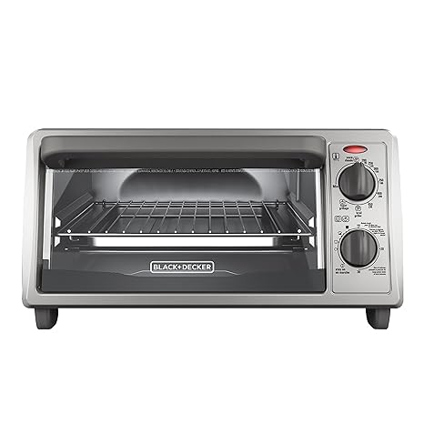

My oven is small so I can only do small parts less than a foot long but it was 40 bucks at target.
