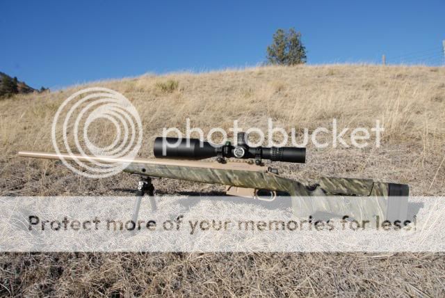

I agree that the preparation is the key. I used a Pro in Billings for my 6.5 x 47 L a few yrs back. Still looks like the day it was picked up. The finish is very durable. I also had my last duty gun a SIG 229 redone in cerakote as the finish was about 50% worn off from my holster. That one has held up very well too.
