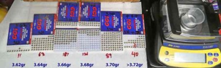

Hi Guys
I thought I would weigh some primers to see what the spread would be. I weighed them on a A&D FX 120i in grams. I don't know how much the difference there would be between the cups and anvils. In other posts I have read they are pretty consistent with their weights. If (Big IF) we just say it's down to the filling then you could possibly see where a flyer could come from. I know there are other factors such as case volume, bullet and powder. The difference between the lightest and heaviest was a bit of a surprise. To the naked eye the anvil did seem to be sitting further out from the cup on the heaviest.
It was a tedious chore and not one I wish to repeat. I certainly don't measure case volume but can't help but wonder if the smallest case capacity was paired with the heaviest primer what would the outcome be at 1000+ yards.

These are SRP, CCI 450.
Try some light vs heavy at several hundred yards. Won't make a hill of beans at 100yds.

I put your numbers in a spreadsheet and sorted by the "Weight" you listed and the second sorted "as fired weight". Here's what that looks like:
Primer weight test by Rocketvapor.jpg Primer weight test by Rocketvapor 2.jpg
