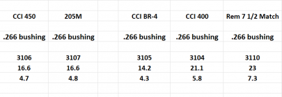

I have had a brick of 205M on the shelf for a backup in case 450s dried up. Decided yesterday to do a little side by side test. Fired nine rounds of CCI-450s, cooled ten minutes and fired nine rounds of the 205Ms. The Garmin gave me the results below.
PS: I am going to bum some 7 1/2 Rems from my son and see how they stack up.
I have been waiting two weeks to get the same range conditions as when I posted the above primer test. The weather was perfect today. 47 degrees and a slight cross wind. I shot all these rounds with about 7-8 minutes between strings. Three three shot groups. The results are amazingly close the the other two.

Been beating 205's and 205M's like rented mules for a couple decades with no problems.
With a good fit between the pin tip and the hole, many brands of primers are 'good'. If you don't, many brands of primers are 'bad'.
Good shootin' :) -Al
can the 205 take the pressure that 450 can take?
In my experience, based on looking for more velo in a 204 ruger and 20P, CCI400< FED205M< CCI450. In loads using 205M I would start getting cratered primers at a certain point. Went to CCI450s to try and that same load which cratered 205M, had no cratering at all and I could run them to get more velo.
This shows me the chart of primers cup thickness correlates to showing signs of cratering, at least in my experience.
