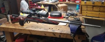

What barrel are you running on that Stevens? I have a .223 Criterion on a Stevens 200 receiver that still gets low .4's after 3K plus rounds down it
Jim, I'm running a Douglas Premium Match 8" twist on my Stevens 200. I also have a Savage 12FV with a Criterion 223 Rem 8" twist barrel. Its the most accurate rifle I own and its a lot of fun to shoot!

Thanks for the kind words K22. Honestly, my shooting skills aren't that great. The only way I can shoot those kind of groups consistently is to use a high end shooting rest and shoot free recoil.
My intent for this rifle is deer hunting and just have fun shooting and tinkering with it. Its just a cheap Stevens action with a decent barrel and a Boyds At-One stock that I installed pillars and bedded. I do compete occasionally but I have other rifles setup for that. They aren't any more accurate than this one though, just better suited for competition.
