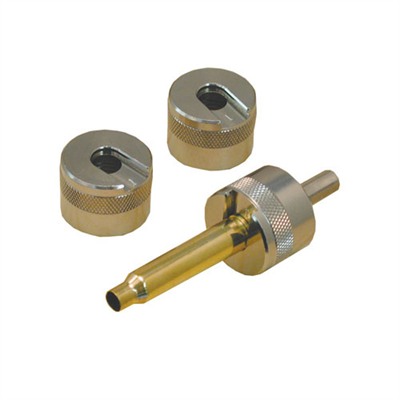

I recently acquired one of the Sinclair caseholders and wish I woukld have found them years ago. I have used the Lee caseholders for years and even purchased the universal caseholder (with the 3 jaws) and none of them come close to the Sinclair. The cases stay tight with minimal force tightening the holder, and I didn't have a single case come loose like I got used to with the Lee. Also the long Hex shaft stays in the chuck of a cordless screwdriver.
Ok... it looks like it's easier than Lee, and the center detent? secures in the primer pocket better? I'm looking into utilizing my Forester neck turner in my vice with a power screwdriver or drill.
Have you looked at the K&M.??? That shiny piece of aluminum is worth it's weight in gold. Once you lock the case down. It's not going any where. That big blue ring saves your hands, especially if you are dealing with the old Arthritis. Just another choice to look at, I gave my 21Century to my son to use, just because the K&M was easier on my hands when locking down and unlocking the case.:)

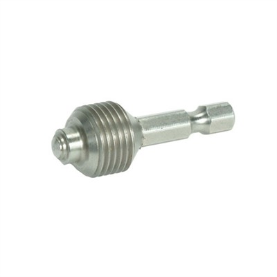

Any case holder like the Sinclair unit below works well because they center the case on the primer pocket.
Meaning far less chance of case wobble when turning.
Below the nipple centers the case in the holder reducing any wobble.
The older sinclairs used a rounded ball end that went into the primer pocket. I think i may still have one if i didnt throw it away. It didnt work at all which is why you dont see many recommendations for them. Glad they finally changed
Both the 21st Century, and the PMA Tool have a closely fitting post that fits into the primer pocket. This is a significant improvement because you don't have to tighten them as much to keep cases in place under the force of turning necks. I have used the others and these are the best. Also, cases run truer with the positive index on primer pockets.
I'm not into cartridge specifics, the universal one looks better, but you have to buy thier shell holder.
I have a few from Sinclair and a few from PMA that came with a used turning tool that I bought. Both of them work well, much better than the Lee tool that I had. K&M makes good stuff and that case holder looks like it would work great.
