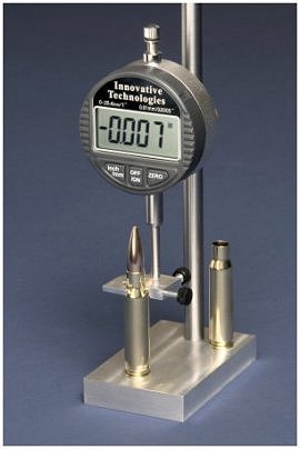

Headspace separation is very easy to avoid. To start with, it can only be caused by excessive chamber clearance,at the shoulder).
I make an inexpensive tool that measures the chamber clearance that YOUR handloads will have in YOUR particular chamber. It gets this information by comparing one of your handloads to one of your fireformed cases.
Check it out on our website WWW.LARRYWILLIS.COM

Larry,
I received my new Digital Headspace Gauge early this week and I was very impress with how sturdy it is, the quality and how easy it is to get repeatable readings with this tool. Is Sure does beat digging out my old Stoney Point tools and attaching parts to my calipers and fumbling through all the inserts to find correct one, then having to fussing around measuring the same case multiple times to insure that I didn't cocked the brass somewhat in the insert which easily will give you a .003 variance. Thanks for a designing and marketing this trouble free instrument at a fair and reasonable price. Folks try it I assure you you'll like it.

Thanks for mentioning our new Digital Headspace Gauge.,It's always good to hear from our customers.) We devised a better way to solve this common problem after hearing from so many shooters with headspace separation problems. I designed our Digital Headspace Gauge to be simple to operate, and able to give much more consistent readings.
Another important feature is that unlike the RCBS Precision Mic, our Digital Headspace Gauge works on ALL calibers. Anyone can read all about this tool on our website.
