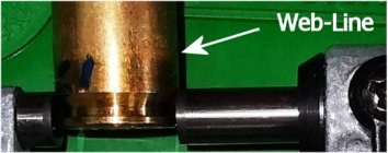

I used to use a blade mic & rig to measure, but found that calipers or a simple QC thickness MIC at the webline actually works better for my testing. The webline being the widest portion of any fired case. Normally I can see the point, but if not I can slide meaurement down the case until I hit it.
This works better because, as mentioned earlier, the webline will fall to a different datum depending on case manufacture. A cheap tool like this works really well:
Below the webline, like near extraction groove, I would be concerned at .0005" expansion.
More than that, whether I accepted it or not, the brass wouldn't be around for long.
