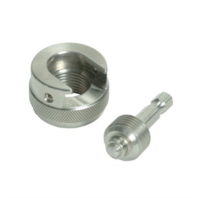

Something like the K&M shell holder power adaptor
the holder from a lee case trimmer. BUT take an unused die lock nut and fit it around the movable part of the holder to make a better hand grip.
I use a 1/2 inch battery powered drill. It will take any case I normally shoot, 6BR, 308 etc. Use the same drill for turning necks with a K&M cutter. I get a lot less wobble than using the Sinclair tool. Slide the bottom of the case all the way in to the bottom of the chuck, and tighten it up.

Its easy with the Lee case holder to lock the case down off center and have case wobble.
The Sinclair neck turning case holder centers the case on the primer pocket as it tightens.
I use the Sinclair Case Holder with a gyroscopic screwdriver to clean my cases
It works really well if you wanna keep the carbon in your neck.

Was a toss up between the Sinclair and 21st Century, I chose the latter because of the o-ring feature and am thoroughly pleased with it. Felt it was a better bang for my bucks and I'm a Sinclair fan. ;)
Another vote for the Sinclair. I started with the Lee but switched to the Sinclair, no regrets.
@Homerange, I was looking at the Lee stuff, but as I need to buy the seperate parts I think it will be close to the cost of a K&M that comes with a case holder. Havent seen any Sinclair stuff local though that would be nice.
