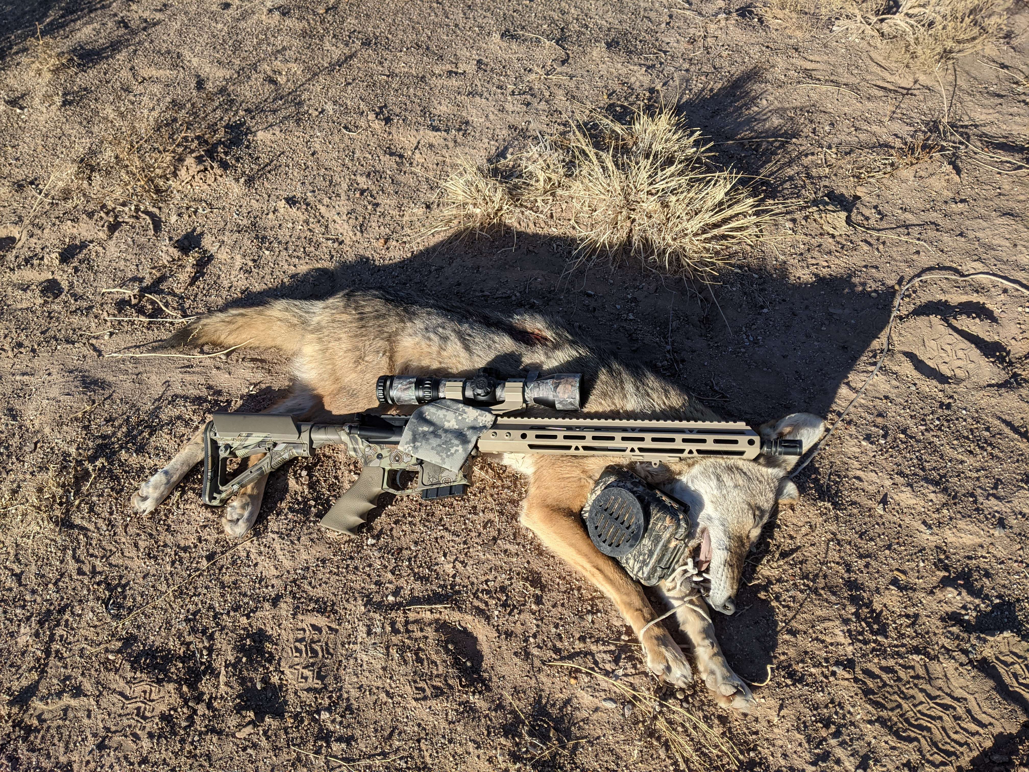

i went with a Dtech. 6mm DTI. Run 65gr Bergers at 3450 fps. Coyote nightmare
