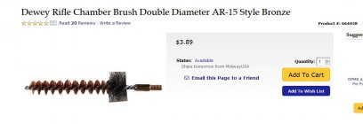

Tried to find a XX75 1816 arrow to make a carbon removal tool and none to be found around here. So question is has anyone made one out of mild steel that would just screw into a cleaning rod? I could whip one out on the lathe. Can't see why it wouldn't work or am I not seeing things right??
At the risk of sounding silly, isn't exactly for this reason that they make chamber brushes? (see below).
It works for me, and I have a borescope to verify it. If you do it regularly you won't get a carbon ring. Of course prevention is the key, just don't trim your brass so short in the first place.
