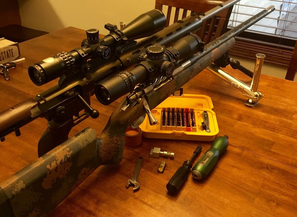

BTW, I'm not scared of carbon barrels, I just don't think this is the application I'd purchase one for:
